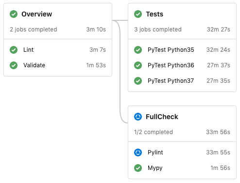

Contributions to Home Assistant are tested against our test suite, code style and typing, to make sure that the contribution does not break things. We have split our test suite into 3 different stages. By using stages, we can run a quick validation stage and fail fast if it’s not correct.
This strategy allows us to not waste any of our workers time on running a full test suite if we know that basic linting is not going to pass.
Below is a screenshot of our CI pipeline for Home Assistant. Because all work is distributed over multiple workers, the total runtime is the longest task in the first column, plus the longest task in the second column.
Screenshot of the Home Assistant CI pipeline.

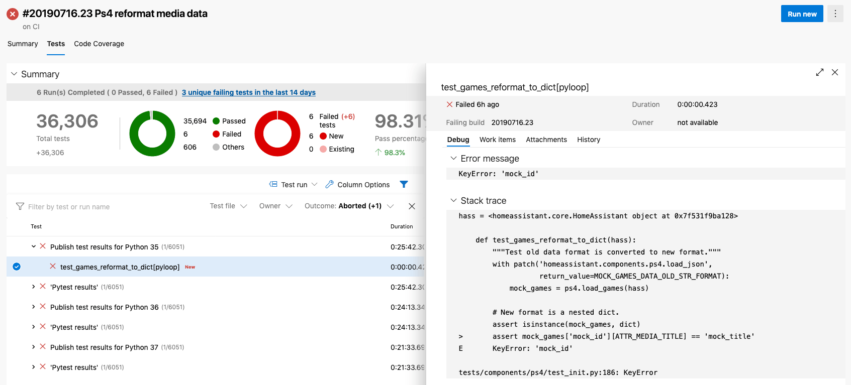

CircleCI had a nice feature that it could distribute your tests over multiple workers by keeping track of the duration of each test. This was reducing the duration of the PyTest suite to around 10 minutes. This is using more agents and we would quickly run out of agents, creating a big backlog. Subsequent stages are only enqueued once the “Overview” stage finishes, causing them to be in the queue behind other contributions that came in.
With Azure, we get more runners which are more powerful and faster, but no parallelization. This means that an individual build will take longer, however, with many builds coming in, the individual build time remains roughly the same, as we are not experiencing any backlog.
Screenshot of the test results.

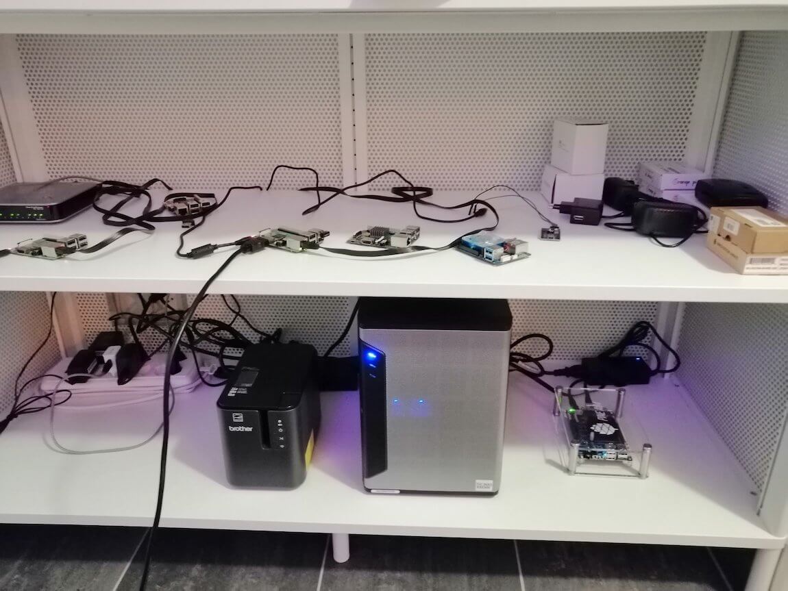

We use a feature on Azure Pipelines called self-hosted agents to host build agents on our own hardware with the right architecture. Azure Pipelines manages the pipeline definition and the orchestration, but the execution runs blazing fast on our own hardware.
Our build cabinet.
