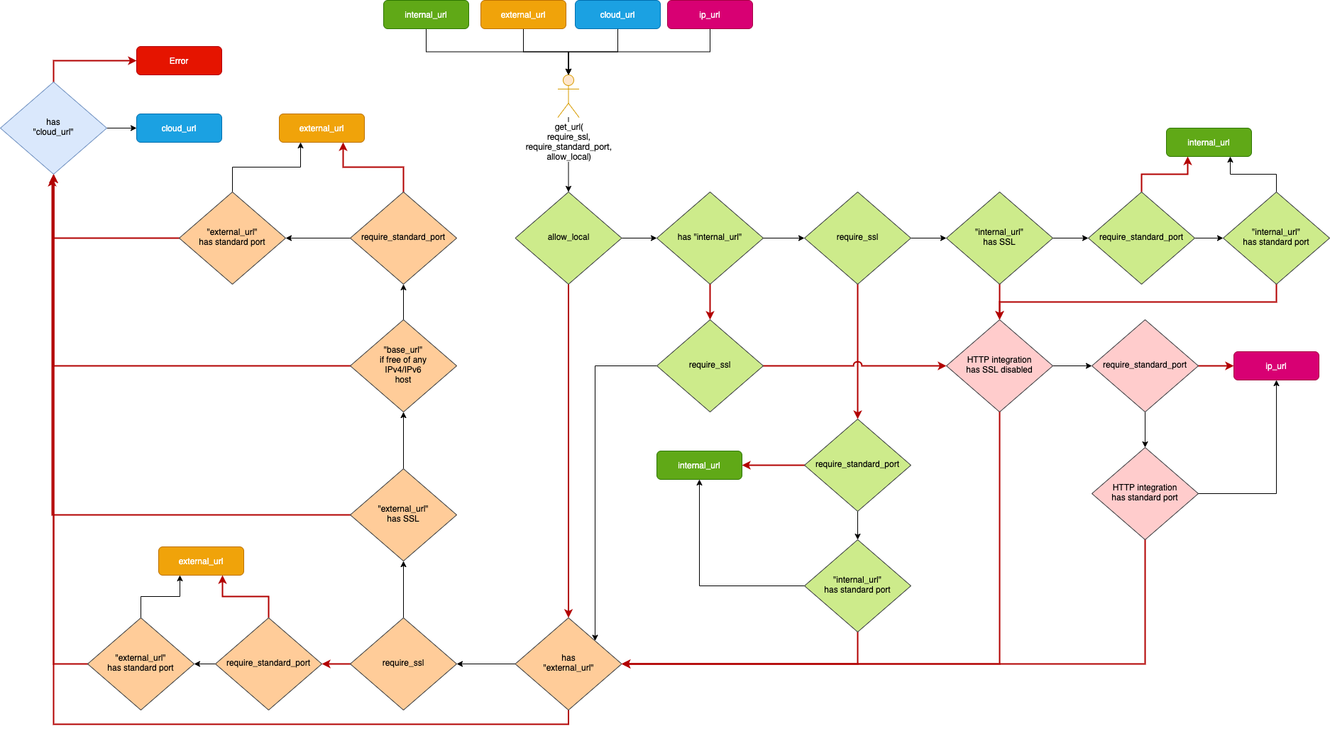

As of Home Assistant Core 0.110, a new instance URL helper is introduced to ease that. We started out with the following flow chart to solve this issue:
Flow chart of getting a Home Assistant instance URL
As a result of this, the previously available base_url is now replaced by two new core configuration settings for the user: the internal and external URL.
From a development perspective, the use of hass.config.api.base_url is now deprecated in favor of the new get_url helper method.
