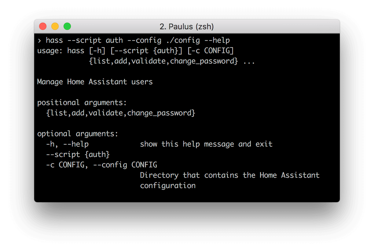

Next step is to create users. Open a terminal and navigate to your Home Assistant installation. The script for managing users is built into Home Assistant and can be invoked using hass --script auth --config /path/to/config.
Screenshot showing the help output of the auth script
