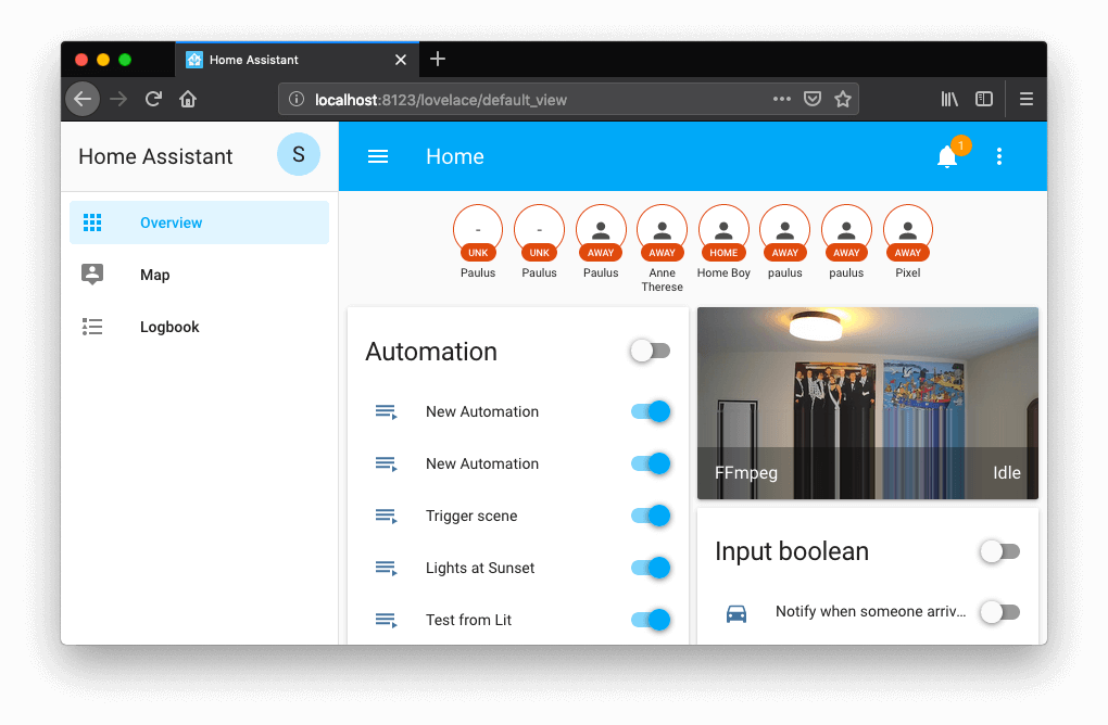

Before Home Assistant 0.90, we were not using any of it. Instead, all users are part of the admin group, as that group provides the same access as before we had permissions. With 0.90, we're going to allow switching the users group between the system groups "admin" and "users". When a user is part of the "users" group, they will not be able to administer Home Assistant. The UI will hide the menu items to open the configuration panel or the developer tools.
Screenshot showing a user in the users group
